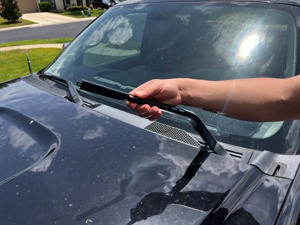

      • Lift the windshield wiper arm away from the windshield until it locks into the service position.
      • Do not let the wiper arm snap back onto the windshield, as it may crack or scratch the glass.
      • Press and hold the small release tab on the underside of the wiper blade where it connects to the wiper arm.
      • Slide the old wiper blade upward until it releases from the wiper arm.
