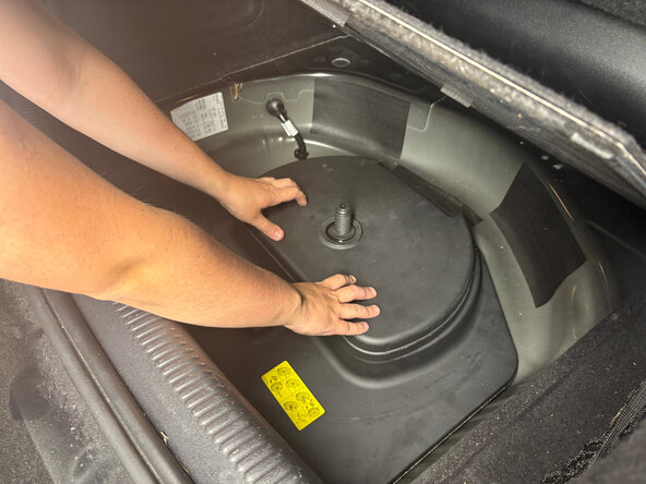

    4. 2012 Audi A5 Spark Plug Replacement: step 4, image 1 of 2 2012 Audi A5 Spark Plug Replacement: step 4, image 2 of 2
      • Grasp the outside edges of the panel beneath the spare tire or the central hole and pull it upwards.
      • This will uncover the car battery compartment.
      Ask FixBot
