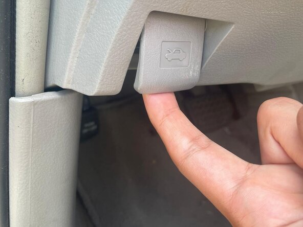

  2. 2011 Toyota Camry Radio Fuse Replacement: step 2, image 1 of 3 2011 Toyota Camry Radio Fuse Replacement: step 2, image 2 of 3 2011 Toyota Camry Radio Fuse Replacement: step 2, image 3 of 3
    • To open the hood, locate the hood release lever beneath the dashboard on the driver’s side near the steering wheel. Pull the lever firmly until you hear a click or pop indicating the hood has released.

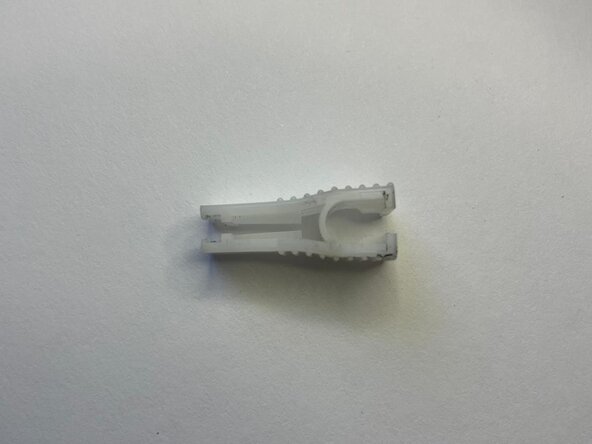

  6. 2011 Toyota Camry Radio Fuse Replacement: step 6, image 1 of 3 2011 Toyota Camry Radio Fuse Replacement: step 6, image 2 of 3 2011 Toyota Camry Radio Fuse Replacement: step 6, image 3 of 3
    • The fuse box cover includes three spare blade fuses β€” a 30A, 15A, and 10A fuse β€” conveniently stored for quick replacements. It also contains a built-in fuse puller that you can use to safely remove and replace any blown fuses.
    • Always match the replacement fuse’s amperage rating with the original to avoid electrical damage or circuit failure.

  8. 2011 Toyota Camry Radio Fuse Replacement: step 8, image 1 of 3 2011 Toyota Camry Radio Fuse Replacement: step 8, image 2 of 3 2011 Toyota Camry Radio Fuse Replacement: step 8, image 3 of 3
    • Use the fuse puller to grip the blown fuse and gently pull it straight out. Insert the new fuse of the same amperage rating into the slot and push firmly until it’s fully seated and secure.
    • Make sure the fuse fits snugly β€” a loose connection can cause the circuit to fail again.
