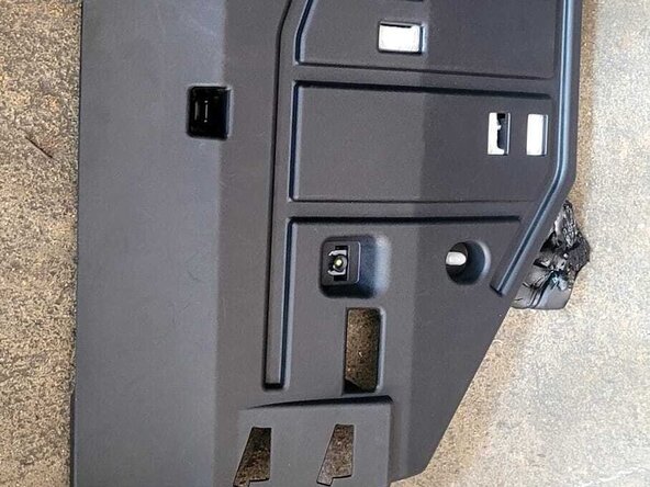

  2. 2011 Lexus CT Aircon blower fan replacement Replacement, Removing the Panel: step 2, image 1 of 1
    • Step#2 - the cover is hold by the inner hooks and toward the passenger the panel is hold quick release clip , locate the "center push tap" ( see photos) and give it a light push and pull gently the panel , it will pop open

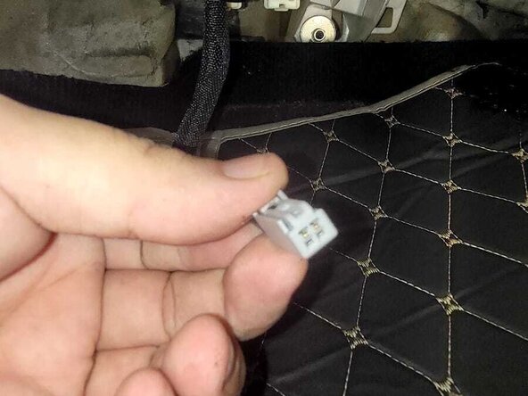

  3. 2011 Lexus CT Aircon blower fan replacement Replacement, Disconnecting the LED wire: step 3, image 1 of 2 2011 Lexus CT Aircon blower fan replacement Replacement, Disconnecting the LED wire: step 3, image 2 of 2
    • Step#3- on the panel , there is a quick connector connecting to LED cabin light , push light the tab or use a small flat driver to push out the connector

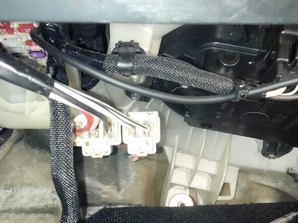

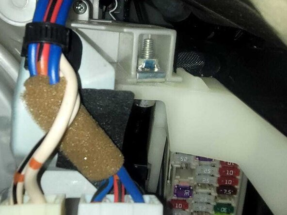

  4. 2011 Lexus CT Aircon blower fan replacement Replacement, Getting the Double Harness Holder out of the way: step 4, image 1 of 3 2011 Lexus CT Aircon blower fan replacement Replacement, Getting the Double Harness Holder out of the way: step 4, image 2 of 3 2011 Lexus CT Aircon blower fan replacement Replacement, Getting the Double Harness Holder out of the way: step 4, image 3 of 3
    • Step#4- one the left passenger facing access screw to the blower fan is blocked by a double harness holder mounting , in order to get it out of the way , it hold in place by a single self tapping #2 phillips screw , it masked by a black termal wire tape, peel a side off , and it be able to see the screw , then use a short driver to unscrew it

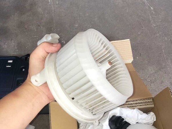

  6. 2011 Lexus CT Aircon blower fan replacement Replacement, Check the Part: step 6, image 1 of 2 2011 Lexus CT Aircon blower fan replacement Replacement, Check the Part: step 6, image 2 of 2
    • Step#6 - after removing the current blower fan , check the part you have is matching
    Ask FixBot
  7. 2011 Lexus CT Aircon blower fan replacement Replacement, Installing the new blower: step 7, image 1 of 2 2011 Lexus CT Aircon blower fan replacement Replacement, Installing the new blower: step 7, image 2 of 2
    • Step#7 - after making sure the connector are matching , using the 3x self tapping M8 screw , and the ratchet . position and align the blower "mouth" with the housing and screw in clockwise , remember not to overtighten , it only handtight strength
