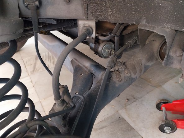

    • The fuel filter of the 2011 Aveo is an inline style unit that's located behind the right rear tire (on the same side as the fuel tank door) and can be seen from outside prior to any disassembly.
    • For the sake of full transparency, this guide has been written by someone who is simply an owner of the vehicle, and not a professional mechanic or other expert. It is entirely likely to contain some errors or omissions, however unintentional.

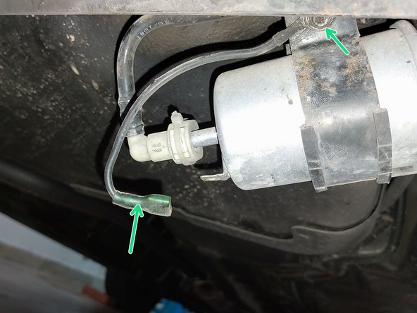

    • We will loosen the ground wire in the filter to be replaced, since this terminal is not included in the new filter, and we will leave the metal clamp cover loose, removing its screw.
    • Discard the 2 plastics as we won't use them for the new filter.

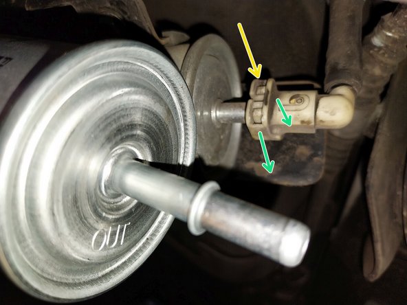

    • To remove the inlet fitting from the filter, you'll need to pry it out carefully with a screwdriver. In this case, it's held in place by a U-shaped plastic piece because the base broke during a previous replacement. Once you've loosened both sides of the U-shaped clip, you can pull on the hose and filter to disconnect them.
    • ⚠⚠⚠ WARNING ⚠⚠⚠ Be careful with gasoline splashes—both when removing the hose from the existing setup and when connecting the new filter to the inlet.
    • Before things get more complicated later on, make sure to remove the mounting clamp from the old filter and attach it to the new one. Heads-up: this step caused me a few issues, which I’ll explain below.
