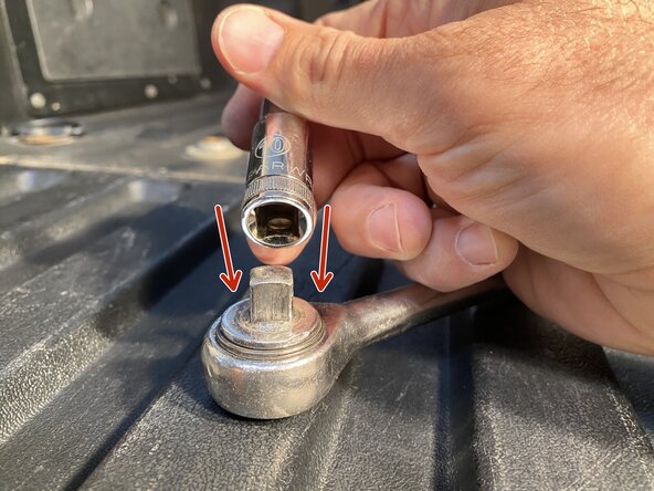

  2. 2010 Tacoma Driver Side Taillight Replacement: step 2, image 1 of 3 2010 Tacoma Driver Side Taillight Replacement: step 2, image 2 of 3 2010 Tacoma Driver Side Taillight Replacement: step 2, image 3 of 3
    • If you are using a open-ended box wrench, move to step 3.
    • If you are using a socket wrench, put together the socket and socket wrench by aligning the socket with the drive post and press the two together.
    • Some socket wrenches having a locking mechanism on the wrench that prevents the socket from accidentally releasing. If the socket does not press onto the socket wrench with a little force, check for a locking mechanism on your wrench, hold it in the release position as you press the socket onto the socket wrench, then release the locking mechanism.
    • Rotate the ratchet lock clockwise or counterclockwise, depending on whether you are removing or installing a bolt.
