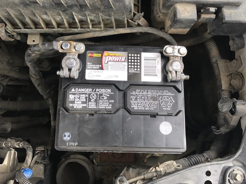

    3. 2006 Kia Spectra Battery Replacement: step 3, image 1 of 3 2006 Kia Spectra Battery Replacement: step 3, image 2 of 3 2006 Kia Spectra Battery Replacement: step 3, image 3 of 3
      • Remove the positive (red circle) cable from the battery using the wrench to loosen the nut and bolt.
      • Then, remove the negative (orange circle) cable battery, using the wrench to loosen the nut and bolt.

    7. 2006 Kia Spectra Battery Replacement: step 7, image 1 of 2 2006 Kia Spectra Battery Replacement: step 7, image 2 of 2
      • Attach the positive (red cirlce) cable to the battery by screwing on the nut and bolt with the wrench.
      Ask FixBot
    8. 2006 Kia Spectra Battery Replacement: step 8, image 1 of 3 2006 Kia Spectra Battery Replacement: step 8, image 2 of 3 2006 Kia Spectra Battery Replacement: step 8, image 3 of 3
      • Then, attach the negative (red arrow) cable to the battery by screwing on the nut and bolt with the wench.
      Ask FixBot
