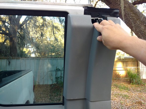

    • Remove the top plastic cover by pulling outward to snap it out of its location.
    • There are not any screws to remove in this part.
  4. 2006 Ford F-150 Door Handle Cable Replacement: step 4, image 1 of 2 2006 Ford F-150 Door Handle Cable Replacement: step 4, image 2 of 2
    • Remove the other plastic cover by pulling outward to snap it out of its location.

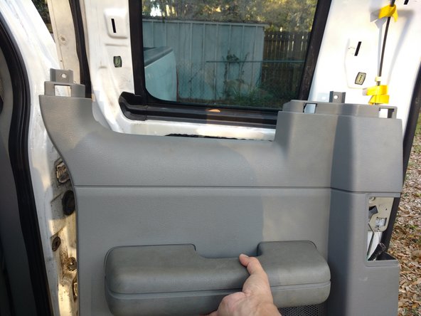

  5. 2006 Ford F-150 Door Handle Cable Replacement: step 5, image 1 of 3 2006 Ford F-150 Door Handle Cable Replacement: step 5, image 2 of 3 2006 Ford F-150 Door Handle Cable Replacement: step 5, image 3 of 3
    • Remove the three 6 mm hex screws off the main door cover using a 6 mm socket. There are two screws at the top and one at the bottom.
    • The panel itself should stay in place even after the screws have been removed.
    • The door panel is maintained in place by plastic hooks behind it.

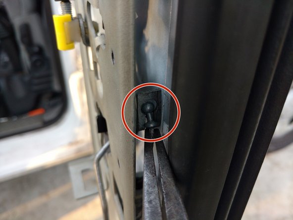

    • Snap out the upper end of the cable out of its location.
    • The upper end of the cable has a shape of a little ball. The little ball is found by where the door handle was removed.
    • Using a plier, lift the cable high enough so that the little ball can come out through the round opening above it.

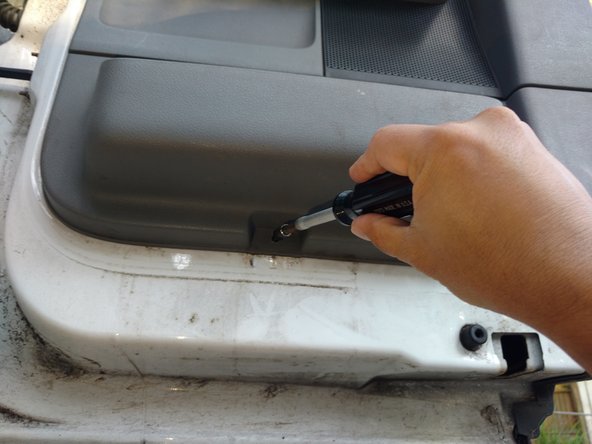

    • Remove the three T27 hex star screws using a tamper torx screw driver. The screws are found at the bottom of the door.
    • You may need a mechanic creeper to lay under the door.
    • Wear protective goggles if you lay down under the door to do this step.
