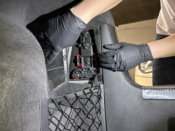

  2. 2005 Volkswagen Jetta Tail Light Replacement Guide: step 2, image 1 of 3 2005 Volkswagen Jetta Tail Light Replacement Guide: step 2, image 2 of 3 2005 Volkswagen Jetta Tail Light Replacement Guide: step 2, image 3 of 3
    • Open panel cover by detaching the hook and loop fastener swinging it open.
    Ask FixBot

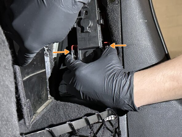

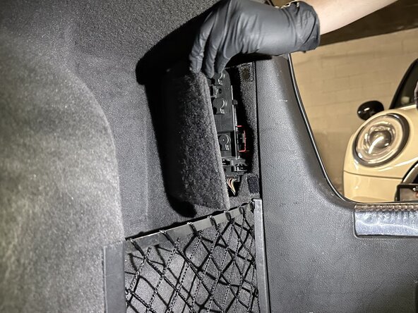

  3. 2005 Volkswagen Jetta Tail Light Replacement Guide: step 3, image 1 of 3 2005 Volkswagen Jetta Tail Light Replacement Guide: step 3, image 2 of 3 2005 Volkswagen Jetta Tail Light Replacement Guide: step 3, image 3 of 3
    • Disconnect the taillight housing connector by pinching the sides of the plug and pulling outwards.
    • Unplugging with take a small amount of force, careful not to pull on the actual wires.

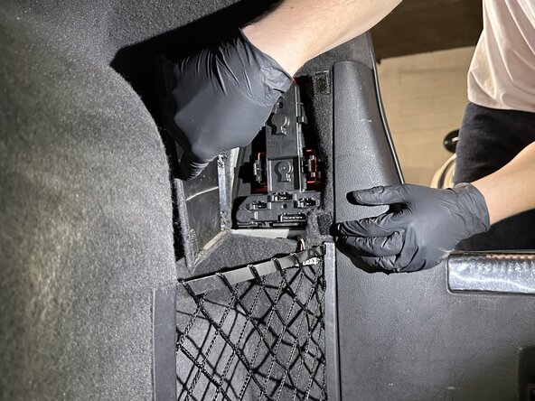

  4. 2005 Volkswagen Jetta Tail Light Replacement Guide: step 4, image 1 of 2 2005 Volkswagen Jetta Tail Light Replacement Guide: step 4, image 2 of 2
    • Tuck the connector out of the way to prepare for removing the tail light housing.

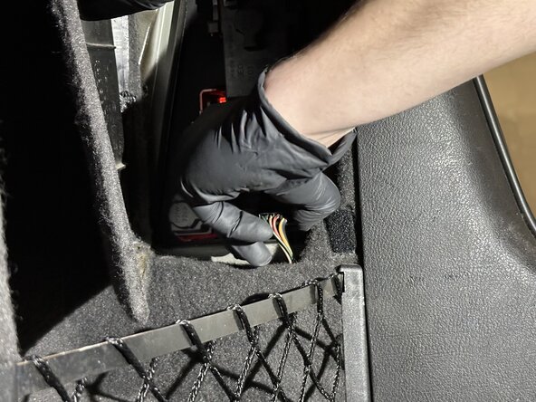

  5. 2005 Volkswagen Jetta Tail Light Replacement Guide: step 5, image 1 of 3 2005 Volkswagen Jetta Tail Light Replacement Guide: step 5, image 2 of 3 2005 Volkswagen Jetta Tail Light Replacement Guide: step 5, image 3 of 3
    • There are two clips, one on each side, that hold the tail light housing in place. Pinch the clips inward, towards each other, to unclip the housing.
    • Once unclipped, the housing can rest freely in its place.

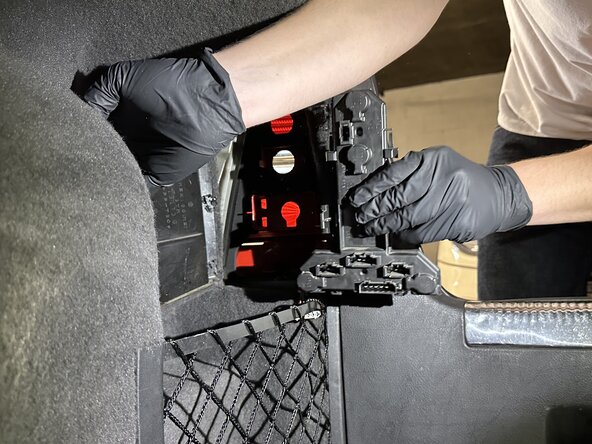

  6. 2005 Volkswagen Jetta Tail Light Replacement Guide: step 6, image 1 of 3 2005 Volkswagen Jetta Tail Light Replacement Guide: step 6, image 2 of 3 2005 Volkswagen Jetta Tail Light Replacement Guide: step 6, image 3 of 3
    • Start removing the housing by simple twisting and pulling. Removing one corner at a time until the whole part is able to be removed.
    • Careful of glass bulbs.

  7. 2005 Volkswagen Jetta Tail Light Replacement Guide: step 7, image 1 of 3 2005 Volkswagen Jetta Tail Light Replacement Guide: step 7, image 2 of 3 2005 Volkswagen Jetta Tail Light Replacement Guide: step 7, image 3 of 3
    • Remove damaged bulb by twisting 90° and replace with new bulb.
    • 5007 tail light bulb
    • 7506 brake light bulb
    • 1156 amber turn signal bulb
    • This method can be used on any of the bulbs located in the housing.
