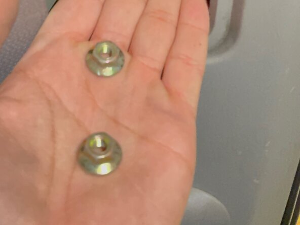

  5. 2005 Toyota 4Runner Rear Taillight Right Replacement, Remove the Taillight Fasteners: step 5, image 1 of 3 2005 Toyota 4Runner Rear Taillight Right Replacement, Remove the Taillight Fasteners: step 5, image 2 of 3 2005 Toyota 4Runner Rear Taillight Right Replacement, Remove the Taillight Fasteners: step 5, image 3 of 3
    • Loosen and remove the bottom bolt/screw as it is easier to access first.
    • *NOTE* The bolts on this vehicle were hand tightened due to previous lightbulb changes so it is much easier to loosen the bolt with your fingers.
    • *REMINDER* If the bolt is too difficult to remove you may use the 10-mm socket wrench in a counter-clockwise motion to loosen. (Not demonstrated as it would jeopardize the control of the already loose bolt).
    • *IMPORTANT* TWO Phillips #2 pan-head screws, Length: 25.4 mm (1.0 in) Thread type: M5 × 0.8 These screws secure the taillight housing to the vehicle body and are removed from the inside edge of the taillight once the rear hatch is open.
    • Remove the two 25.4 mm Phillips #2 pan-head screws (M5 × 0.8) securing the taillight assembly to the vehicle body.
    • *REMINDER* Keep the screws organized to ensure proper reinstallation.

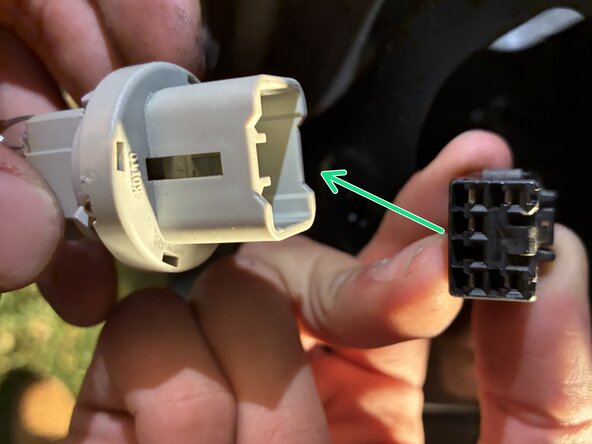

  6. 2005 Toyota 4Runner Rear Taillight Right Replacement, Unclip the Wire Harness: step 6, image 1 of 3 2005 Toyota 4Runner Rear Taillight Right Replacement, Unclip the Wire Harness: step 6, image 2 of 3 2005 Toyota 4Runner Rear Taillight Right Replacement, Unclip the Wire Harness: step 6, image 3 of 3
    • Unclipping the wiring harness will allow for the complete removal of the light housing.
    • Use a flat head screwdriver or something strong but thin to push the release style button on the top of the harness.
    • Give the wire a light tug away from the harness and it will release.

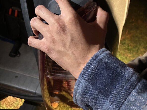

  8. 2005 Toyota 4Runner Rear Taillight Right Replacement, Release the Taillight Housing: step 8, image 1 of 3 2005 Toyota 4Runner Rear Taillight Right Replacement, Release the Taillight Housing: step 8, image 2 of 3 2005 Toyota 4Runner Rear Taillight Right Replacement, Release the Taillight Housing: step 8, image 3 of 3
    • Place one hand on the outer lens of the taillight and the other on the inner edge
    • Gently pull the taillight straight out toward you, away from the body of the vehicle.
    • *CAUTION* Do not yank, the housing is held by plastic alignment pins that pop out of rubber grommets.
    • Wiggle it slightly while pulling straight out. You can gently tap the outer edge with the palm of your hand to help it pop loose.

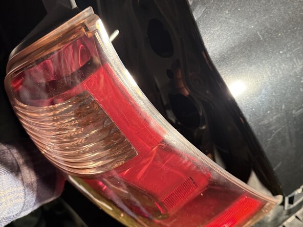

  9. 2005 Toyota 4Runner Rear Taillight Right Replacement, Familiarize yourself with Housing Components: step 9, image 1 of 3 2005 Toyota 4Runner Rear Taillight Right Replacement, Familiarize yourself with Housing Components: step 9, image 2 of 3 2005 Toyota 4Runner Rear Taillight Right Replacement, Familiarize yourself with Housing Components: step 9, image 3 of 3
    • A wiring harness going into the back.
    • Disconnect the wiring harness in order to fully remove the light housing. A good tug should do it for most of these harnesses. If no, a small push tab may be present to release the harness. (Not required in this situation).
    • Inside the taillight housing you’ll typically see several bulb sockets: Commonly: Upper bulb = brake/taillight. Middle bulb = turn signal. Lower bulb = reverse light. Turn the housing so you can easily see and reach all the bulb sockets.

  10. 2005 Toyota 4Runner Rear Taillight Right Replacement, Identify the Burnt Bulb: step 10, image 1 of 3 2005 Toyota 4Runner Rear Taillight Right Replacement, Identify the Burnt Bulb: step 10, image 2 of 3 2005 Toyota 4Runner Rear Taillight Right Replacement, Identify the Burnt Bulb: step 10, image 3 of 3
    • Look for the bulb that looks darkened, cloudy, or broken inside.
    • *REMINDER* Before disassembly, you can have someone press the brake pedal / turn signal / reverse while you look to see which function is out.

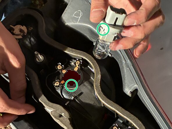

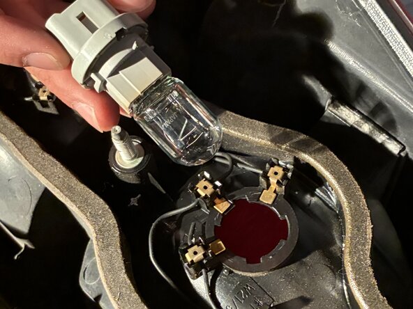

  11. 2005 Toyota 4Runner Rear Taillight Right Replacement, Remove the Bulb Socket from the Housing: step 11, image 1 of 3 2005 Toyota 4Runner Rear Taillight Right Replacement, Remove the Bulb Socket from the Housing: step 11, image 2 of 3 2005 Toyota 4Runner Rear Taillight Right Replacement, Remove the Bulb Socket from the Housing: step 11, image 3 of 3
    • Grab the plastic socket (the part that goes into the housing).
    • Twist the socket counterclockwise (left) about a quarter turn.
    • Pull the socket straight out from the taillight housing.
    • Now the bulb will be exposed and attached to the socket.

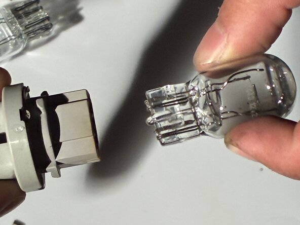

  12. 2005 Toyota 4Runner Rear Taillight Right Replacement, Remove the Old Bulb: step 12, image 1 of 3 2005 Toyota 4Runner Rear Taillight Right Replacement, Remove the Old Bulb: step 12, image 2 of 3 2005 Toyota 4Runner Rear Taillight Right Replacement, Remove the Old Bulb: step 12, image 3 of 3
    • Hold the socket firmly.
    • With your other hand, grab the bulb
    • Pull it straight out from the socket.
    • *CAUTION* Discard the old bulb safely, beware of possible broken pieces.

  13. 2005 Toyota 4Runner Rear Taillight Right Replacement, Install the New Bulb: step 13, image 1 of 3 2005 Toyota 4Runner Rear Taillight Right Replacement, Install the New Bulb: step 13, image 2 of 3 2005 Toyota 4Runner Rear Taillight Right Replacement, Install the New Bulb: step 13, image 3 of 3
    • Line up the base and push straight in until fully seated.
    Ask FixBot
  14. 2005 Toyota 4Runner Rear Taillight Right Replacement, Reinstall the Socket into the Taillight Housing: step 14, image 1 of 3 2005 Toyota 4Runner Rear Taillight Right Replacement, Reinstall the Socket into the Taillight Housing: step 14, image 2 of 3 2005 Toyota 4Runner Rear Taillight Right Replacement, Reinstall the Socket into the Taillight Housing: step 14, image 3 of 3
    • Line up the socket tabs with the opening in the taillight housing. Insert the socket into the hole.
    • Twist the socket clockwise (right) until it locks in place. It should feel snug and not wiggle.

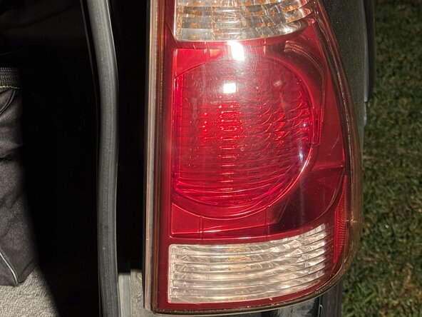

  17. 2005 Toyota 4Runner Rear Taillight Right Replacement, Final Check: step 17, image 1 of 3 2005 Toyota 4Runner Rear Taillight Right Replacement, Final Check: step 17, image 2 of 3 2005 Toyota 4Runner Rear Taillight Right Replacement, Final Check: step 17, image 3 of 3
    • Step back and visually inspect:
    • The taillight should sit evenly and flush with the body. There shouldn’t be any gaps or misalignment.
    • *REMINDER* Turn the lights on one more time to confirm: Tail, brake, turn signal, and reverse lights all work as they should on that side.
