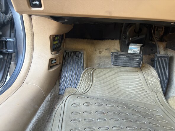

    • As a responsible car owner, the first step is to open the hood and locate the car battery.
    • Opening the hood is a simple task. Locate the button, which is conveniently placed on the left-hand side of the steering wheel, across from the accelerator and brake.

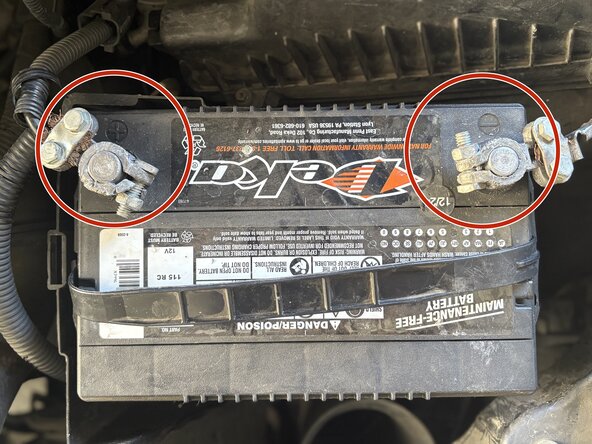

    • Find the battery under the hood.
    • Identify the positive (+) and negative (–) terminals. The positive (+) is on the left and the negative (-) is on the right.
