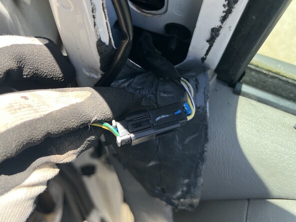

    3. 2001 Chevy Astro Passenger Side-View Mirror Replacement: step 3, image 1 of 3 2001 Chevy Astro Passenger Side-View Mirror Replacement: step 3, image 2 of 3 2001 Chevy Astro Passenger Side-View Mirror Replacement: step 3, image 3 of 3
      • Use electrical disconnect pliers (or a similar tool) to release the locking tabs on the mirror wire connectors.
      • Once the tabs are lifted, disconnect the connectors by pulling them in separate directions.
      Ask FixBot

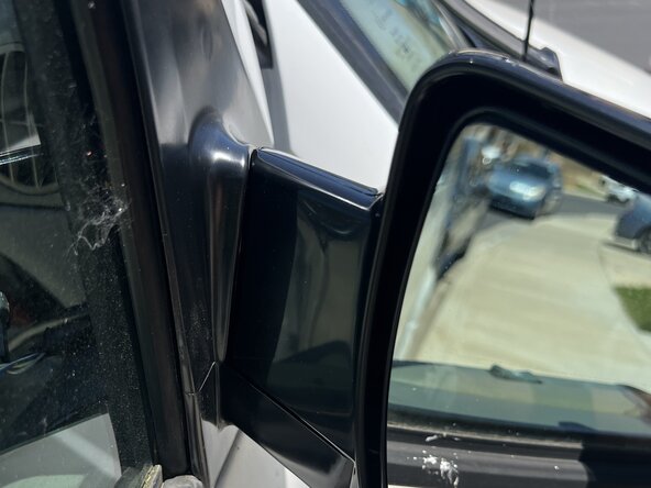

      • Now do a final inspection from the interior and exterior sides of the door to make sure your new passenger side-view mirror for your 2001 Chevy Astro van has been installed coorectly.
      Ask FixBot
Make sure the mirror assembly is secure in place and is positioned to your liking!
