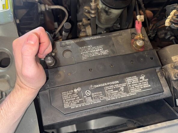

  2. 2000 Ford Explorer Limited Cam Shaft Sensor Replacement: step 2, image 1 of 3 2000 Ford Explorer Limited Cam Shaft Sensor Replacement: step 2, image 2 of 3 2000 Ford Explorer Limited Cam Shaft Sensor Replacement: step 2, image 3 of 3
    • Disconnect the negative battery terminal. This is the terminal marked with the black cable on the battery. Partially unscrew the bolt to loosen the connection and remove the cable. Ensure the cable and wrench DON"T contact the other battery terminal, or other metal parts of the car.
    • If the negative battery cable comes into contact with the positive cable, it will cause a short circuit, resulting in electrical sparks and fire. The same will happen if the wrench comes into contact with both cables at once. Use caution and awareness when completing this step.
    • Use a ratcheting wrench to loosen the bolt securing the negative battery terminal, but leave it attached to the cable. Do not remove the bolt.

  8. 2000 Ford Explorer Limited Cam Shaft Sensor Replacement: step 8, image 1 of 3 2000 Ford Explorer Limited Cam Shaft Sensor Replacement: step 8, image 2 of 3 2000 Ford Explorer Limited Cam Shaft Sensor Replacement: step 8, image 3 of 3
    • Ensure the car is still OFF when this is done and DON'T let the cable OR wrench come into contact with the other battery cable or other metal parts of the car. Do not turn on the car until this cable is firmly secured in its correct position.
    • If the negative battery cable touches the positive cable, it can cause a short circuit, producing sparks and potentially starting a fire.
    • Reattach the black negative battery terminal.
    • Use a wrench to tighten the screw.
